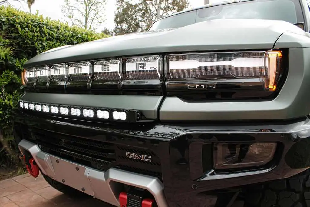

For those running a roof-mounted light bar, how much extra wind noise does it create? I’m leaning toward the M&R front bumper-mounted light bar.
Is anyone using the M&R Hummer EV Bumper 40in Light Bar-PRO?

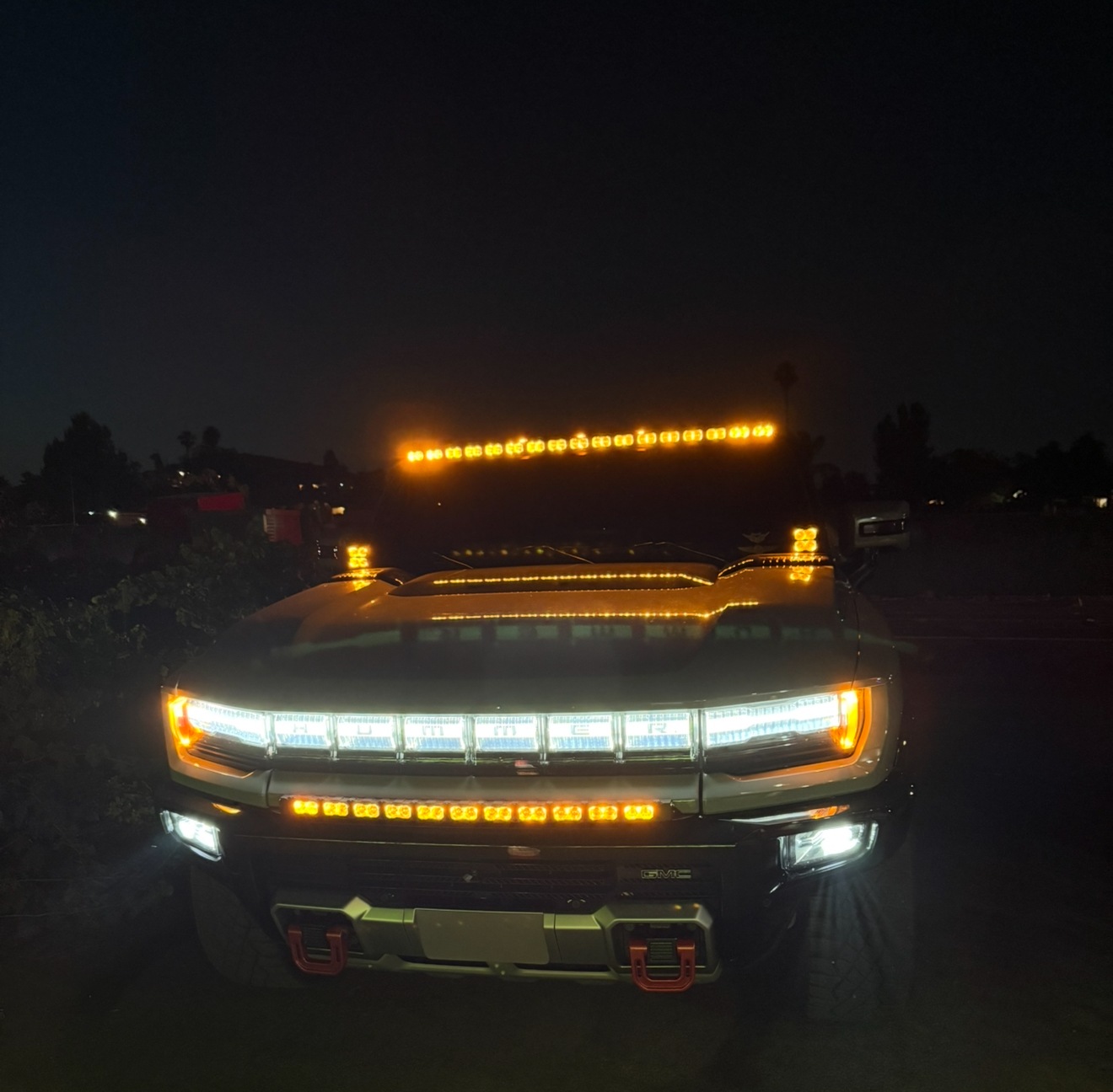

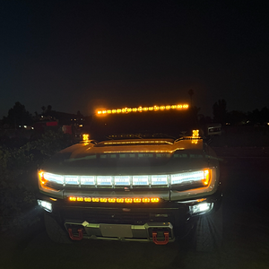

M & R installed in Burbank. Mike was so professional and fast! They mount the small squares back off the hood unlike GM that mounts to the hood and only give you white lights! You pick your color, white or amber. I bought module at GM for $460 and select Hummer top left and get aux 1-6. White is 1,2,3 and Amber is 4,5,6 in infotainment. Clean

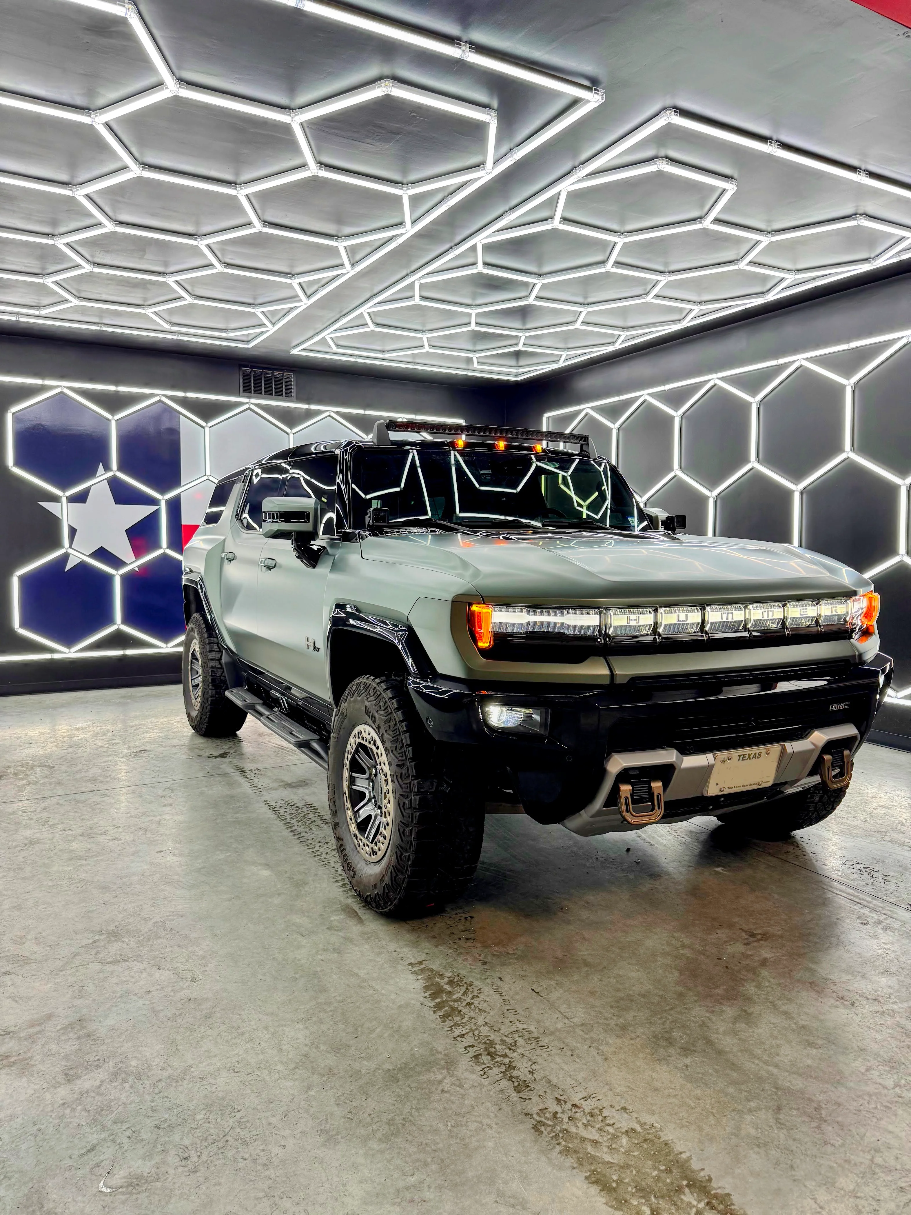

No wind noise and I prefer the GMC Accessory lights over the aftermarket because they don't block the signature 3 yellow clearance lights that define the Hummer. Plus being higher up you get less windshield wash out from the lights reflecting off the windshield.
