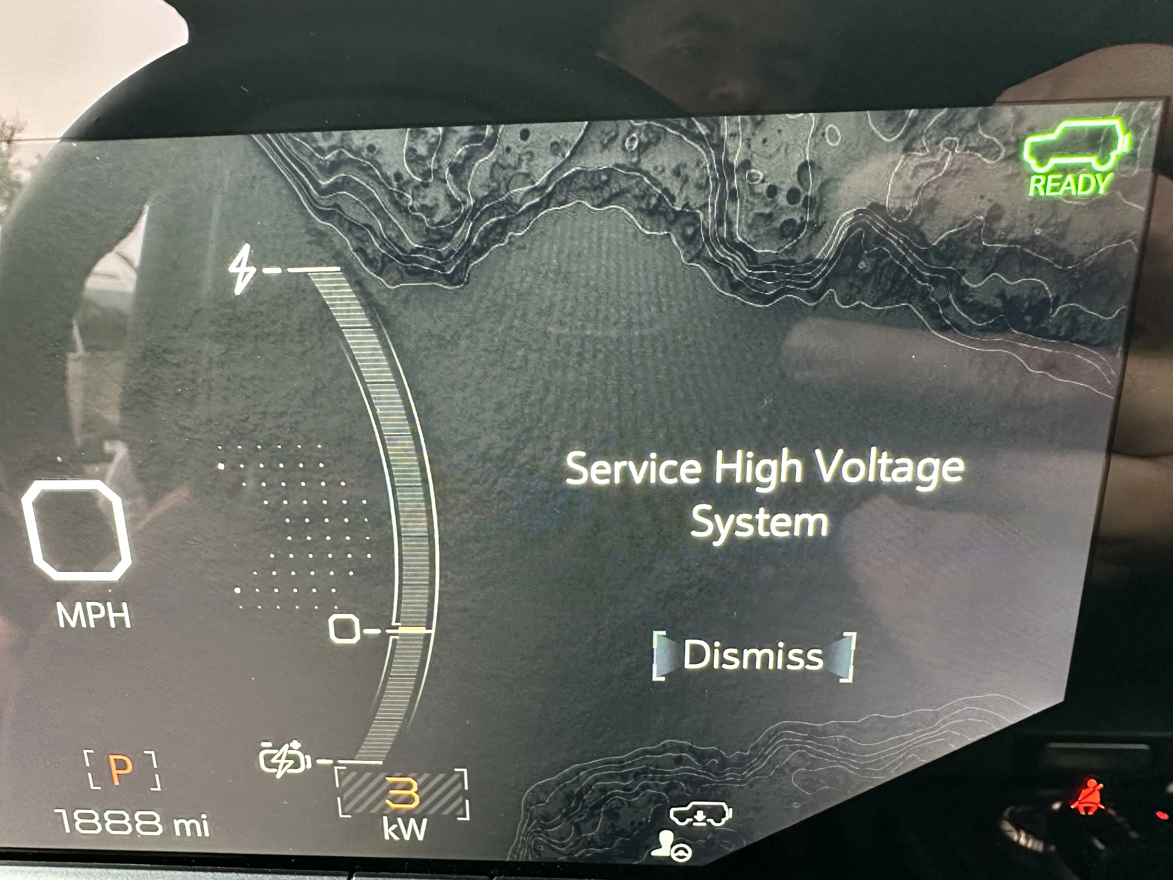

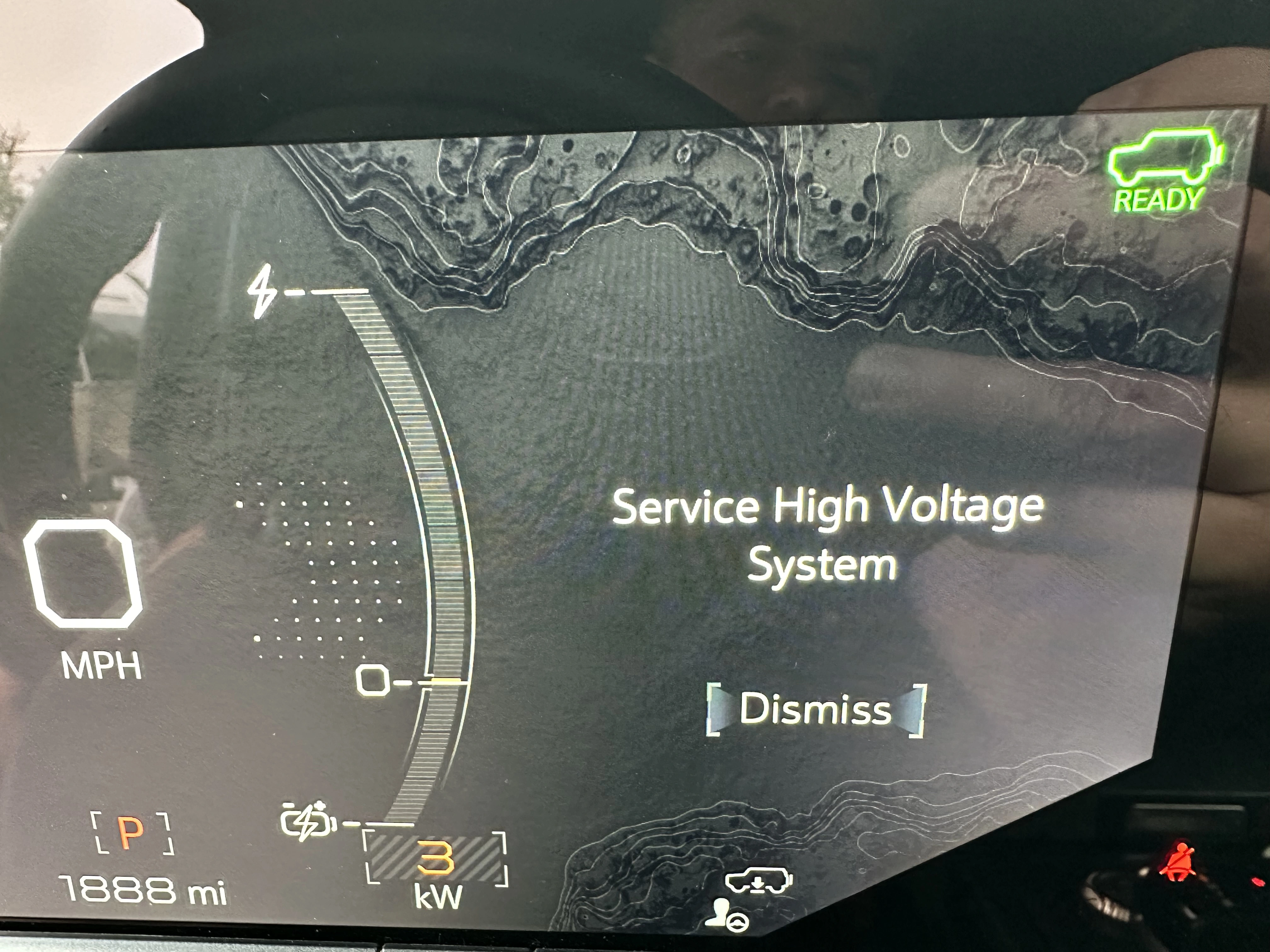

Well, 2 months and 2 payments in, I got the dreaded "Service High Voltage " warning message pop up. It seems to drive find, but won't charge. So looks like another trip to the dealer next week. :(

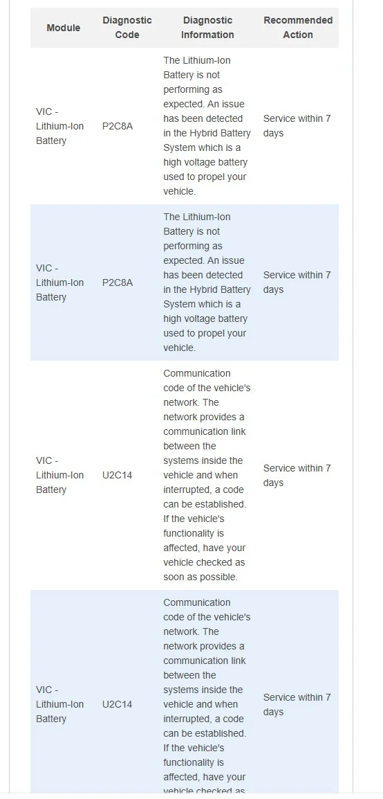

Just checking in here with others. I just had this happen to me today and had to be towed to Williamson Cadillac in Miami. They already have terrible service timeframes without being anEV so this threat is making me nervous. I will say that I have 12k on vehicle and this is my first issue. the only time I have been at the dealer before now, was to rotate my tires. attached is the OnStar snip of the diagnosis if anyone has some insight.
