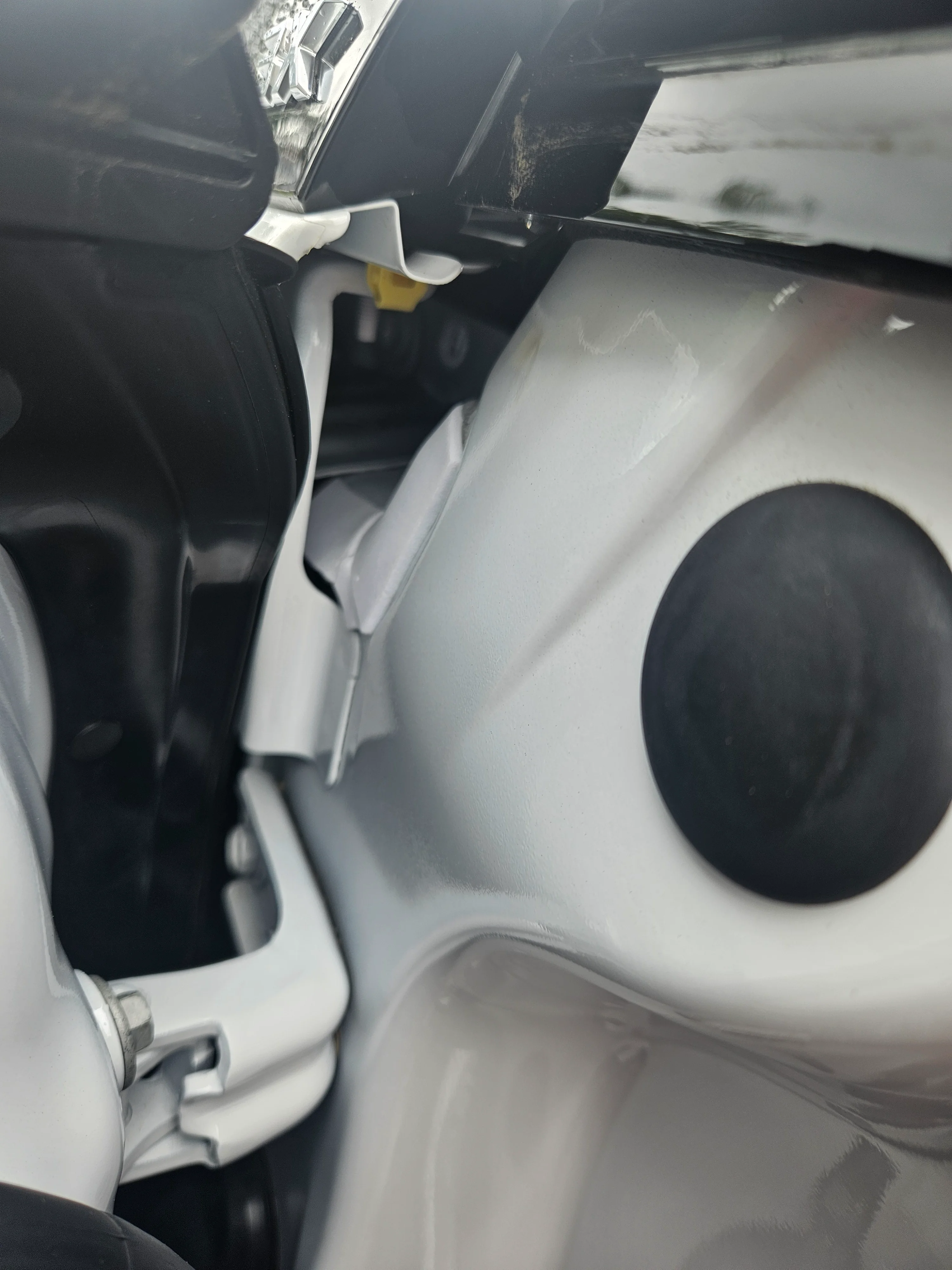

I had the same issue, put some adhesive foam where I guessed water was coming in from to electric panel by drivers side. Never had problem since..
