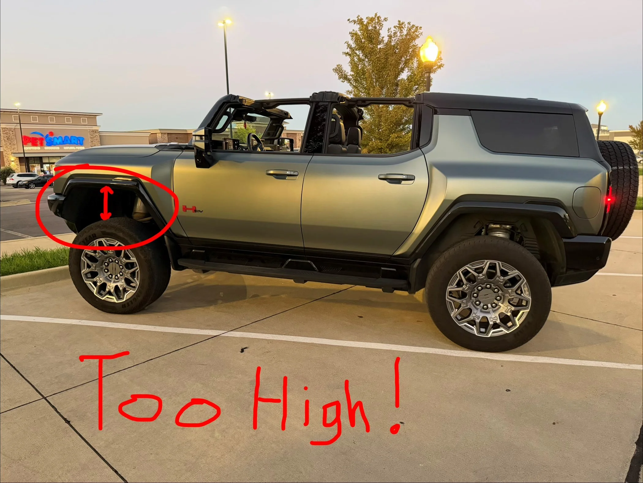

I would set the ride-height to "Increased", and it would raise up to the correct height as it should. However, when I start rolling forward, the front-end would immediately raise up to "Extract height", or close to it, and stay stuck there. Note that I'm not in "Terrain mode" when this happens and it's only the front-end raising up so the truck looks like it's doing the "Carolina squat". Obviously, it's not very drivable when it does this as the suspension gets very stiff and bouncy and the steering all wonky. When I'm able to get it back down to normal/default ride-height, it would drive normal again; with the exception being, it would do a similar behavior in normal/default ride-height after coming out of WTF mode.

While driving at various rates of speed and during moderate acceleration, the front-end of the vehicle will raise up uncharacteristically high and sustain a "hang time" that is uncharacteristically long before settling out. During this behavior, the vehicle becomes very hard to control. The front tires "chirp and squeal" as they fight for traction. The shocks become very stiff and bouncy as the they max out. The steering becomes very loos and erratic. This is because the front tires struggle to keep traction as they lose front-end weight and move to a positive camber. PLEASE NOTE, I am well aware of this vehicle's driving dynamics. I know how the front end naturally comes up when accelerating which is normal. What's happening now goes WAY beyond the normal behavior and with only MODERATE acceleration; and it has never done this before.
