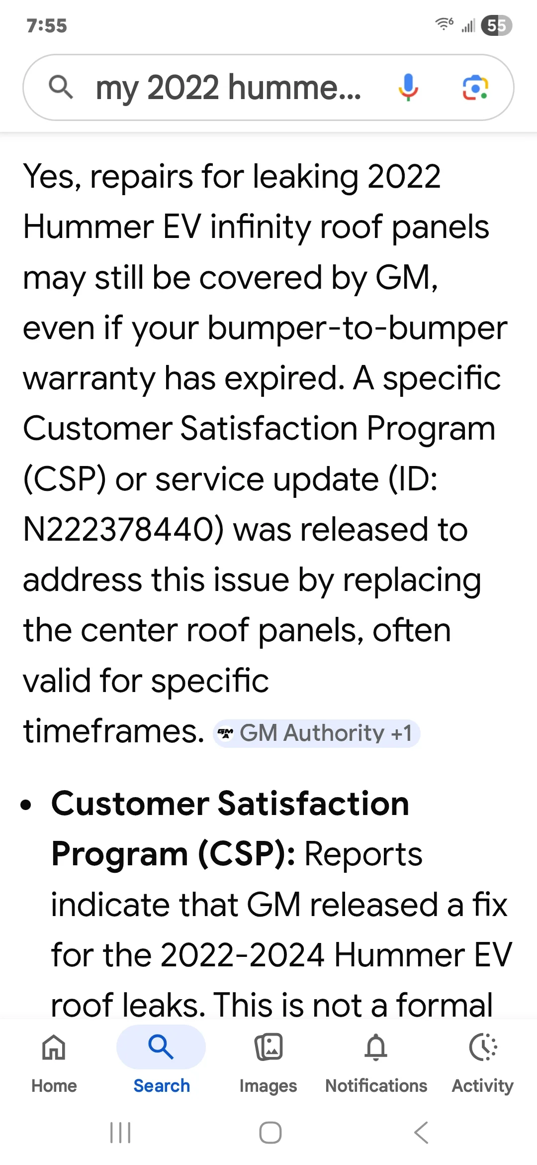

The actual Customer Satisfaction Program number for the roof leaking is N222378440. And just a note, it doesnt matter whether or not the vehicles 3 year bumper to bumper has expired....that reference number covers any issue. It is GM's way of saying " we know there is an issue and we screwed up". Bought mine 2 weeks ago, drove it 1 day...water dripped on my pants and a cup holder had 1/2" of water in it and this was after it sat in the garage for 4 days. Now its been sitting at the dealership garage for 6 days being repaired ( I hope ).

This is not true I have a 2022 and had a water leak “fixed” that was coming through the front sky panels under the bumper to bumper warranty. The warranty expired and now it’s leaking in the back sky panels. I asked GM service if the leak is covered in the back area through the N222378440 customer satisfaction program and they flat out said no. I would suggest to anyone who owns a Hummer to keep testing the roof panels and if there’s a leak get it fixed while still under the bumper to bumper.

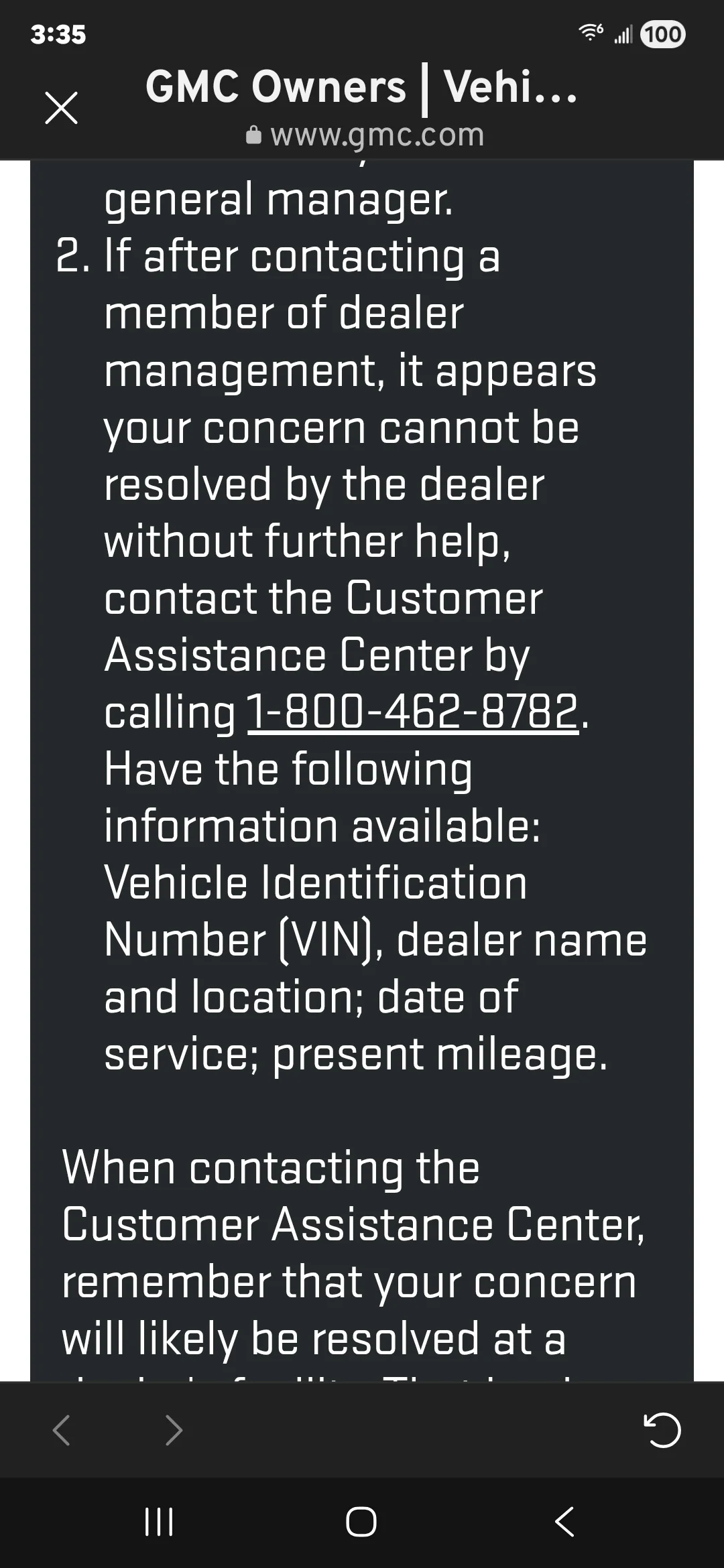

I would not give up that easily. My first attempt with the first technician also turned out to be a big fat "No can do ". Then I made a phone call to GM customer service and they made a phone call to the dealer that said " no " and changed it to a " yes ". Customer service info is attatched.

Thanks for the number, I called and they told me if my bumper to bumper warranty is expired I’m SOL for getting that leak fixed.
Sorry to hear that...I just bought my 2022 the first part of January...24000miles, bumper to bumper already expired. They bent over backwards to accommodate me...not only a roof leaking but they also replaced my power tonneau cover because it had a CSP number associated with its defect. I'd try a different GM dealership.
